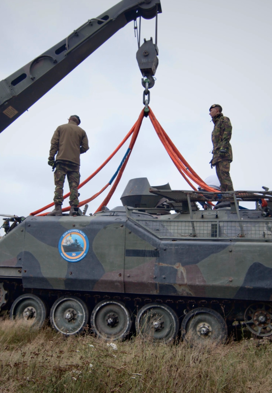

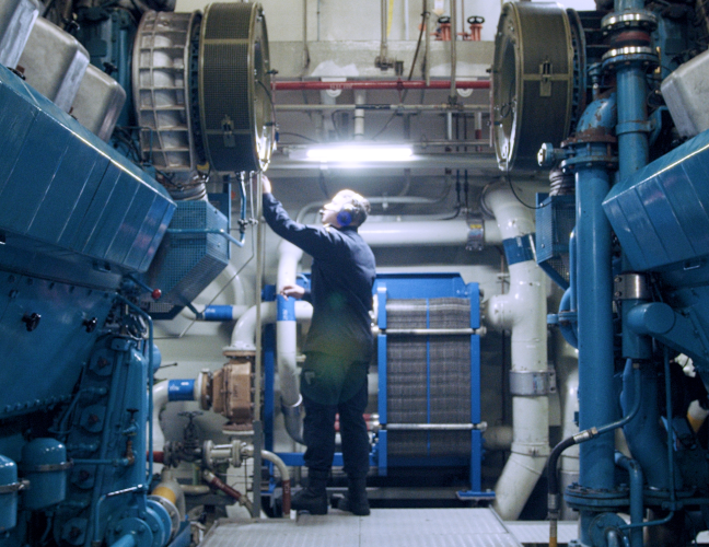

Lifting a 12 Ton Tank
To showcase the strength of advanced 3D printing, UltiMaker collaborated with the Royal Netherlands Navy and Covestro to design and produce a carbon fiber composite link. The resulting 2-kilogram part successfully lifted a 12-tonne armored vehicle, proving that additive manufacturing can create reliable, load-bearing parts for the most demanding applications.

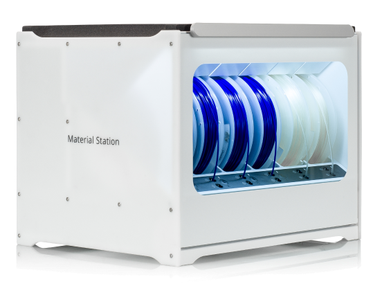

UltiMaker Material Station
The UltiMaker Material Station seamlessly integrates with the S6 and S8 3D printers, holding up to six spools of material, automatically detecting materials via NFC, and switching between them as needed.

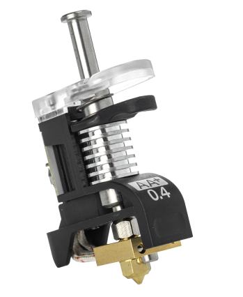

High flow print cores
The new AA+ and CC+ print cores, exclusive to the UltiMaker S6 and S8, have a new quad-chamber design. Allowing for 2.5x more flow and also help regulate the pressure in the print head for cleaner prints.

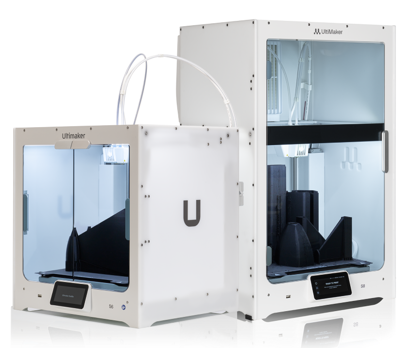

S8 Secure Specifications
Dimensions
Build volume
The physical space inside the UltiMaker S8 that can be used for single or dual extrusion 3D printing.
330 x 240 x 300 mm (13 x 9.4 x 11.8 inches)
Assembled dimensions
The 3D printer's dimensions, including the spool holder.
W 495 x D 585 x H 800 mm (W 19.5 x D 23 x H 31.5 inches)
Printing technology
This is the process of depositing layers of filament, one on top of the other, to build up shapes and models. It is a form of additive manufacturing technology and the process used by all UltiMaker 3D printers.
Fused Deposition Modeling (FDM)
Compatible filament diameter
The filament diameter that achieves optimal results on UltiMaker S series 3D printers.
2.85 mm
Weight
The net weight of the 3D printer.
30 kg (66.1 lbs)
Shipping weight
39 kg (85.9 lbs)
Maximum power output
The peak power output that the printer can reach – usually when the heated bed and hot ends are heating up.
500 W
Dimensional accuracy
*Typical accuracy based on selected geometries, materials (tested on Tough PLA and PLA), and randomly selected machines
± 0.15 mm ± 0.15% feature nominal length*
Extrusion flow
The rate at which melted filament is pushed through the nozzle.
Up to 35 mm3/s
XY speed, acceleration, jerk
"XY speed" refers to the movement speed of the print head along the X and Y axis, "acceleration" is how quickly the print head can change its speed on the X and Y axis, and "jerk" is the rate at which the acceleration changes.
Up to 500 mm/s, up to 50.000 mm/s2, up to 100.000.000 mm/s3
Printer properties
Layer resolution
A micron is the measurement used to define the thickness of a 3D printed layer. 20 micron is 0.02 mm thick. Thinner layers are used for high-detail prints, thicker layers are great for fast prototypes.
60 - 400 microns (depending on the print core nozzle size and print profile)
XYZ resolution
The more accurate the stepper motors within the printer, the greater degree of accuracy and finer resolution can be achieved with each print.
6.9, 6.9, 2.5 micron
Feeder type
Enhanced feeders on the UltiMaker S7 move filament at a precise rate with an abrasive resistant feeder gear that's ready to print with composite materials. Flip the ergonomic locking lever to easily insert or remove your 3D printing materials.
Dual-geared feeder, reinforced for composite materials
Display
The award-winning touchscreen gives you intuitive control over your setup and shows a preview of your print. Supported languages: English, Dutch, French, German, Italian, Japanese, Korean, Portuguese, Russian, Spanish, Simplified Chinese.
4.7-inch (11.9 cm) color touchscreen
Print core replacement
Faster print core changes mean higher uptime and easier maintenance. The UltiMaker S8 comes with print cores for build (AA+) A print core for support materials (BB) is available separately.
Swappable print cores
Print head
Thanks to swappable print cores, you can quickly switch between different filaments and material-matching print cores. This results in higher uptime and easier maintenance of your 3D printer.
Dual extrusion print head with an auto-nozzle lifting system, swappable print cores, and flood detection.
Nozzle diameters
Smaller nozzle diameters enable more detailed prints, large diameters reduce overall print time. This 3D printer ships with two AA 0.4 mm print cores and one BB 0.4 mm print core.
0.25 mm, 0.4 mm, 0.6 mm, 0.8 mm
Travel speed and acceleration at which the print head can move.
Extrusion flow
Volume of material pushed through the print cores per unit of time.
Up to 35 mm3/s
System on module
ARM cortex quadcore at 1.8 GHz
Real-time controller
600 MHz Arm-cortex M7
Operation parameters
Filter technology
The printer will notify you when the filter needs replacing (every 1,500 print hours - about once per year).
Replaceable EPA filter
Air extraction rate
The volume of air extracted per hour by the low-noise, brushless fan.
1 - 50 m³/h (35 m³/h nominal rate for most materials at 23 °C)
Nozzle temperature
A wide nozzle temperature range means greater flexibility in the 3D printing material choice.
Up to 340 °C (644 °F)
Nozzle heat-up time
The nozzle heat-up time relates to how fast you can start printing, as well as how fast it can melt the polymer filament.
< 2 minutes
Operating sound
Thanks to their quiet operation, Ultimaker 3D printers are suitable for use in the office, studio, or classroom environment.
< 50 dBA
Build plate leveling
The redesigned print head of the UltiMaker S8 uses a more accurate inductive sensor to scan the build plate at multiple points. It then compensates for any Z-axis offset by adjusting the height of your print's first layers.
Advanced active leveling with more accurate inductive sensors
Build plate
Simply bend the build plate and your 3D printed parts pop off. PEI coating allows for excellent adhesion without glue or support structures. 25 magnets and 4 pins ensure it can be replaced effortless with one hand.
PEI-coated flexible steel build plate
Build plate heat-up time
The build plate heat-up time relates to how fast it can reach the print-ready temperature.
< 5 minutes (from 20 to 60 °C)
Operating ambient temperature
This Ultimaker 3D printer operates best in locations between these temperatures.
15 - 32 °C (59 - 90 °F)
Non-operating temperature
This Ultimaker 3D printer can be safely stored or left inactive at these temperatures.
0 - 32 °C (32 - 90 °F)
Ecosystem
Supplied free software
UltiMaker Cura is our industry-leading slicing software that turns your 3D model into a file your printer can use. Use UltiMaker Digital Factory to manage printers and print jobs via your local network or the cloud.
UltiMaker Cura – print preparation software UltiMaker Digital Factory – All-in-one cloud-based print, printer and user management software
Supported OS
MacOS, Windows, and Linux
Plugin integration
More plugins are available from Ultimaker Marketplace to make your 3D printing experience even easier.
SolidWorks, Siemens NX, Autodesk Inventor
Supported file types
An STL file is the most used file type for 3D printing. Nearly any 3D modeling software program is able to create these files.
UltiMaker Cura: STL, OBJ, X3D, 3MF, BMP, GIF, JPG, PNG Printable formats: G, GCODE, GCODE.gz, UFP
Safety and compliance
Certification
CE, FCC, VPAT, RoHS, REACH, CB, BIS, KC, PSE, RCM, SRRC, MIC, NCC, Safe unattended professional use
More information
Learn more about UltiMaker S8 safety and compliance.

Printer properties
Layer resolution
XYZ resolution
The more accurate the stepper motors within the printer, the greater degree of accuracy and finer resolution can be achieved with each print. *Typical accuracy based on selected geometries, materials, and randomly selected machines
Feeder type
Enhanced feeders on the UltiMaker S6 move filament at a precise rate with an abrasive resistant feeder gear that's ready to print with composite materials. Flip the ergonomic locking lever to easily insert or remove your 3D printing materials.
Display
Faster print core changes mean higher uptime and easier maintenance. The UltiMaker S6 comes with print cores for build (AA+) A print core for soluble materials (BB) is available separately.
Print head
Dual extrusion print head with an auto-nozzle lifting system, swappable print cores.
Nozzle diameters
Smaller nozzle diameters enable more detailed prints, large diameters reduce overall print time. This 3D printer ships with two AA+ 0.4 mm print cores.
Extrusion flow
Up to 35 mm3/s
System on module
Nozzle temperature
Up to 340°C (572 °F) supported with the CC+ print cores
Nozzle heat-up time
< 2 minutes
Operating sound
< 51 dBA
The print head's capacitive sensor scans the build plate at multiple points and compensates for any Z-axis offset by adjusting the height of your print's first layers.
Build plate
Steel flex plate
Ecosystem
UltiMaker Cura – print preparation software UltiMaker Digital Factory – printer management software
Supported OS
Plugin integration
Certification
More information
Learn more about UltiMaker S6 safety and compliance (https://support.ultimaker.com/s/3d-printers/s-series)
