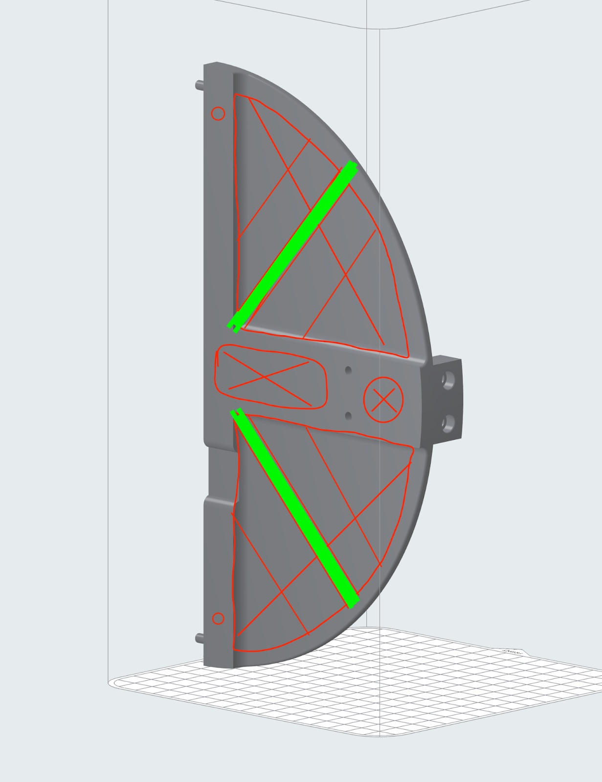

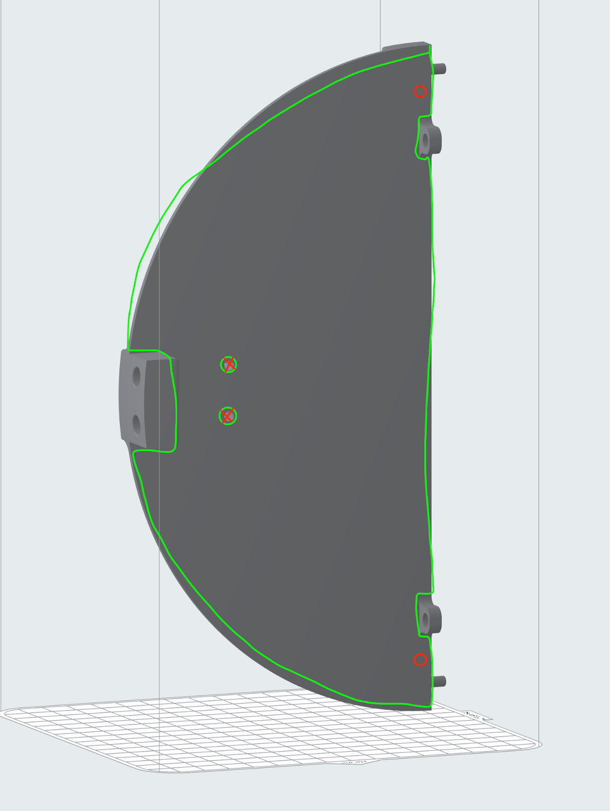

Sketches illustrating ways to optimize the bracket and its cover plate

Thanks to precise design iterations and slicing optimization in UltiMaker Cura, the team cut the original print time dramatically - from 10 hours down to just 3 hours and 12 minutes. Compared to legacy systems, the UltiMaker S6 proved nearly twice as fast as earlier models, while still delivering excellent surface quality and dimensional accuracy.

  • Optimized for speed and performance Smart design and slicing techniques slashed print time by over 65%, without compromising print quality.
