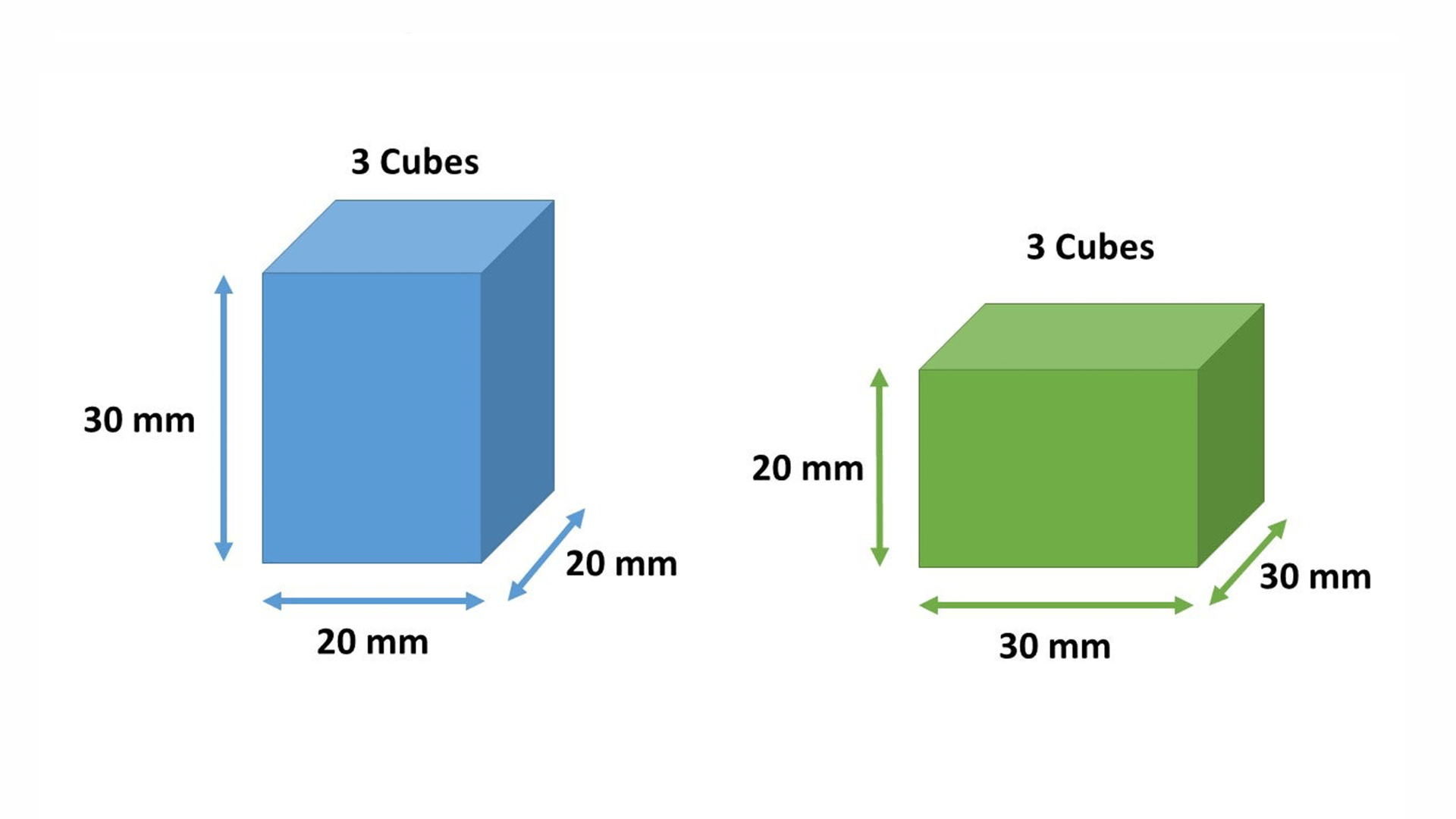

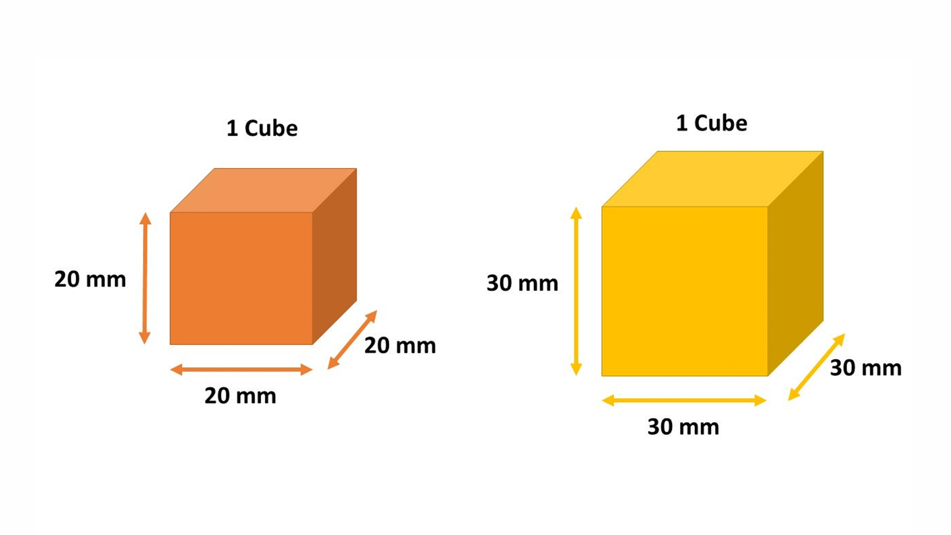

TinkerCAD software was used to design the cubes. The dimensions are provided in the images for reference. The side A was chosen to be 2 cm and B was chosen to be 3 cm. Rest of the calculations follow as per the equation:

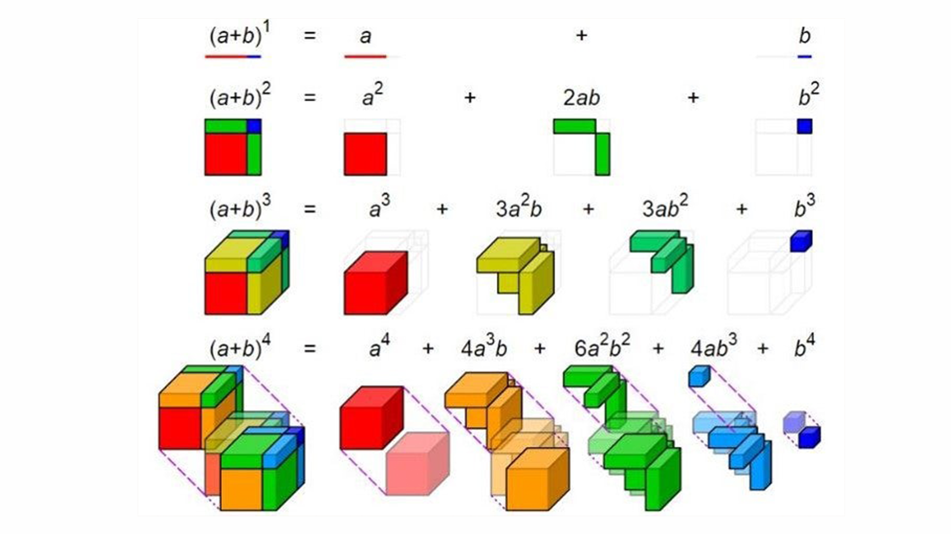

(A+B)³ = A³ + 3A²B + 3B²A + B³
Theoretical Explanation of the Math Expression with 3D Models
A³ and B³ Model Dimensions
A²B and B²A Model Dimensions

For example:
(a+b)0 = 1
(a+b)
1 = a1+b1 = a+b
(a+b)
2 = a2+2ab+b2
(a+b)
3 = a3+3a2b+3ab2+b3
(a+b)
4 = a4+4a3b+6a2b2+4ab3+b4

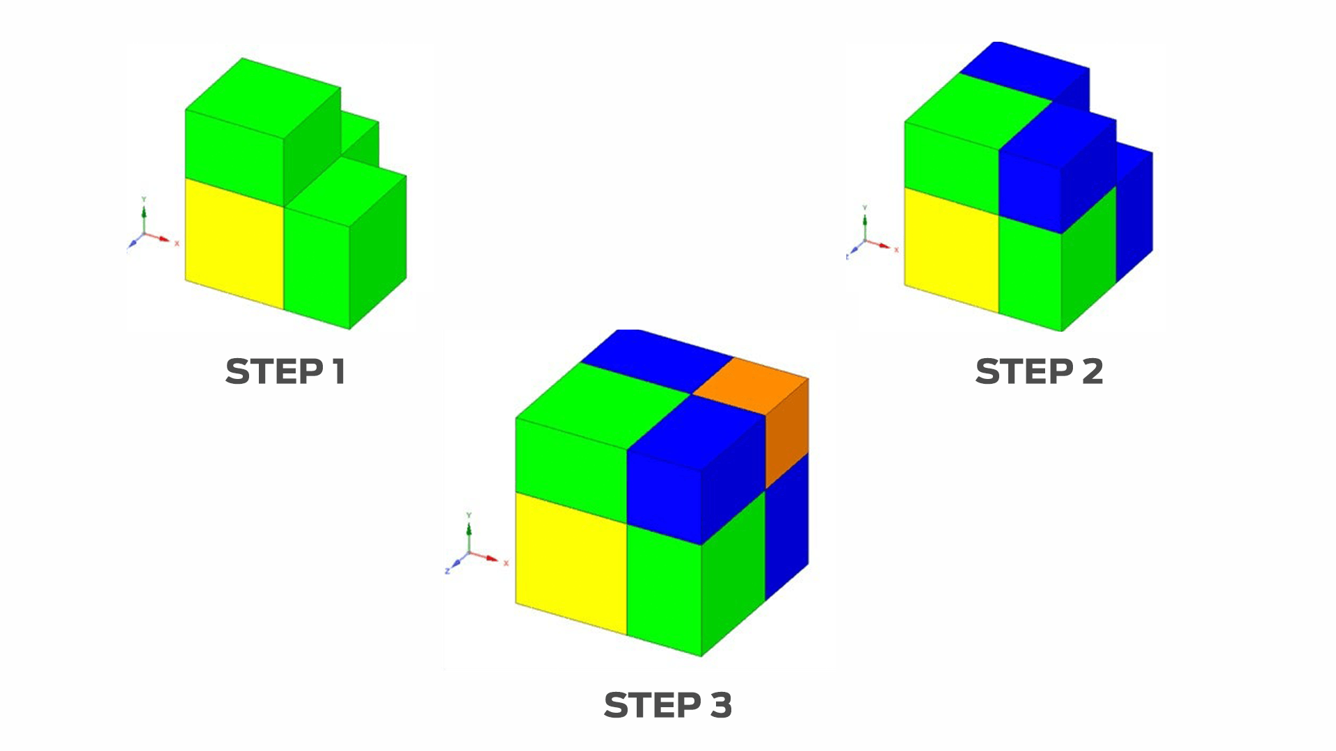

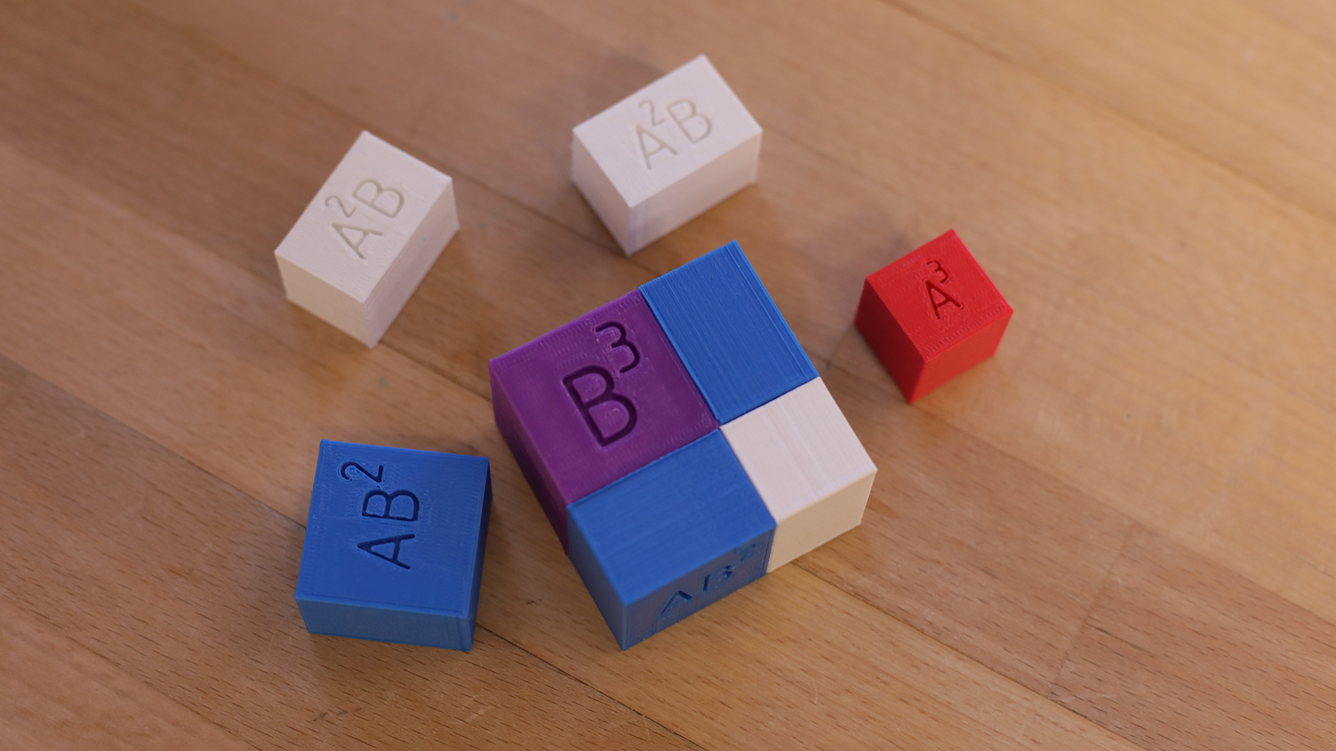

For a group of 30 Students, you may have to split them into a batch of 5 students each. So for each batch you would need one set of cubes without names engraved on them and one more set of cubes with names engraved in them. During the first 75% of the teaching pedagogy you would need only the cubes without the names engraved.
After the printing of a cube is initiated, you may collect the cubes (without names) back and then hand over the cubes with names and teach them the mathematical expression and ask them to assemble.
The A²B and B²A models need to be printed in quantities of 3 each. The A³ and B³ models need one quantity each.
Remember: in order to print them in different colors, you will have to load them separately.
