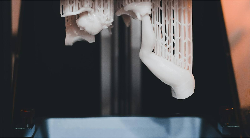

SLA printing utilizes a photosensitive liquid resin that is cured layer by layer using ultraviolet light. This process allows for exceptionally high resolution and smooth surface finishes, making it ideal for intricate designs and detailed prototypes. SLA printers can achieve layer heights as small as 25 microns, resulting in parts with minimal visible layer lines.

Resin printers can achieve layer heights as small as 25-50 microns, resulting in exceptionally smooth surfaces with minimal visible layer lines. This high resolution allows for the reproduction of intricate details and complex geometries. For example, professional SLA printers can produce walls as thin as 0.2 mm and embossed or engraved details as fine as 0.1-0.15 mm.

In contrast, resin printers require more careful handling and post-processing steps. The workflow for resin printing includes:
  • Pouring liquid resin into the vat
  • Printing the model
  • Removing the print from the build plate
  • Washing the print in isopropyl alcohol to remove uncured resin
  • Post-curing the print under UV light
  • Removing support structures
  • Optional sanding of support marks
