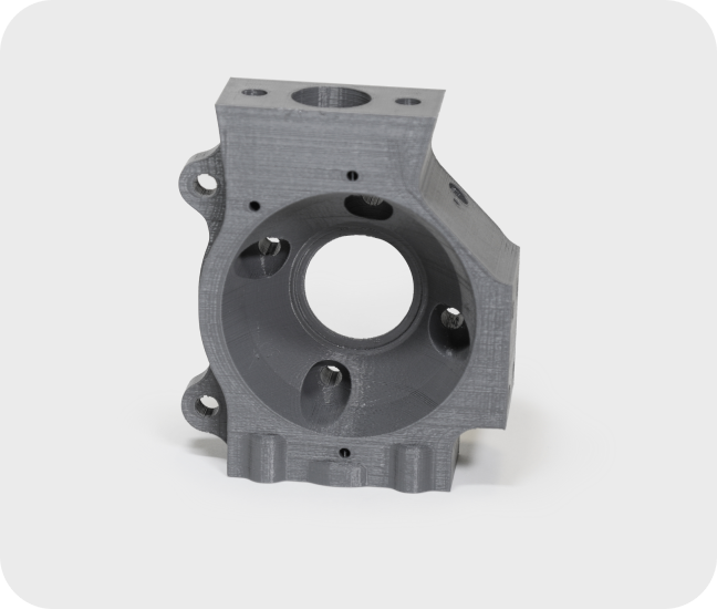

Tough PLA is a material that is great for mid-stage prototypes because of its ease of use and office-friendliness. An added benefit over PLA is its durability, pliability, and machinability which makes it perfect for snap fits and assemblies.
