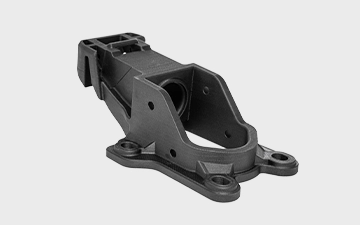

Factor series materials
3D print with high performance filaments
Unlock a vast array of new 3D printing possibilities on Factor 4 with our high-performance filaments. Explore a diverse range of material properties, from extreme temperature and chemical resistance to intrinsic flame retardance, high stiffness, and impressive flexibility. Each filament comes with perfectly tuned print profiles, is NFC-enabled, and includes best-in-class technical and safety data sheets for an unparalleled printing experience.

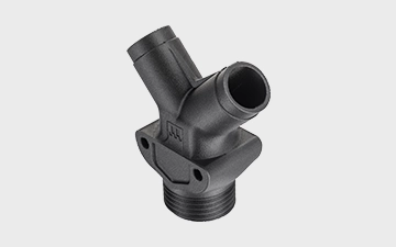

UltiMaker PPS Carbon Fiber
UltiMaker PPS CF is a carbon fiber reinforced polyphenylene sulfide (PPS) filament and the next level composite material for the UltiMaker Factor 4. It has excellent performance while still being easy to print using HT print cores.
Learn more

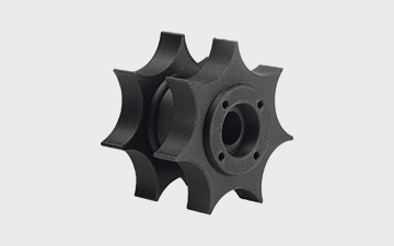

UltiMaker Nylon CF Slide
UltiMaker Nylon CF Slide is a high-performance, PFAS-free filament that delivers excellent wear resistance, temperature stability up to 180°C after annealing, and a robust Z tensile strength exceeding 40 MPa. Ideal for replacing POM in complex, custom designs
Learn more
