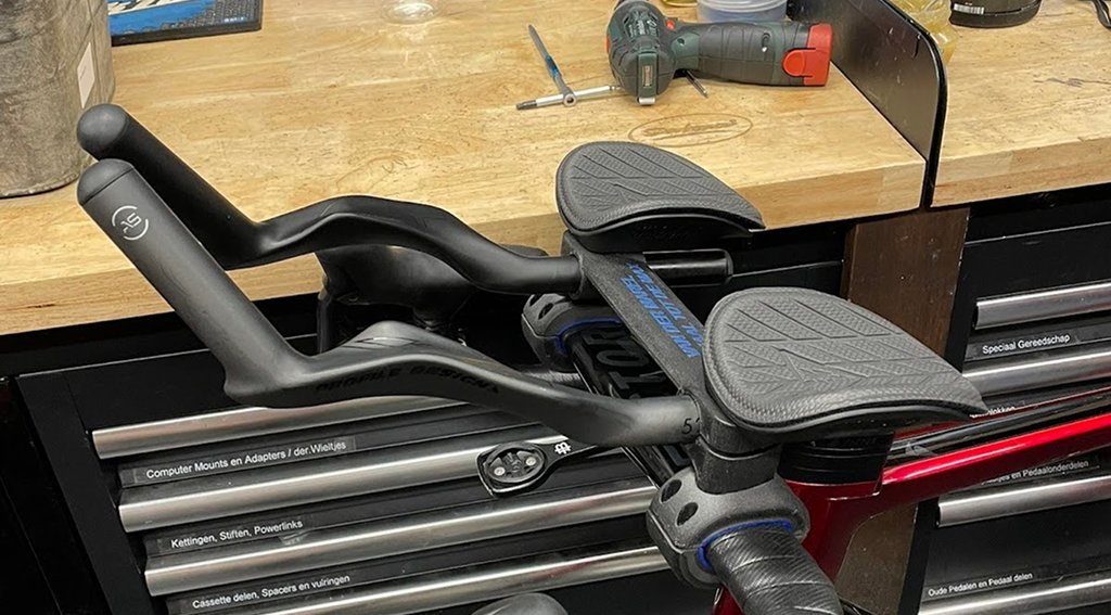

At Wielerhuis Marel, a specialized bike workshop in the Netherlands, owner and head mechanic Pim van der Marel faced a unique problem. A customer wanted to mount a set of aerobars onto a road bike, but the bike’s handlebar design didn’t support standard mounting hardware.

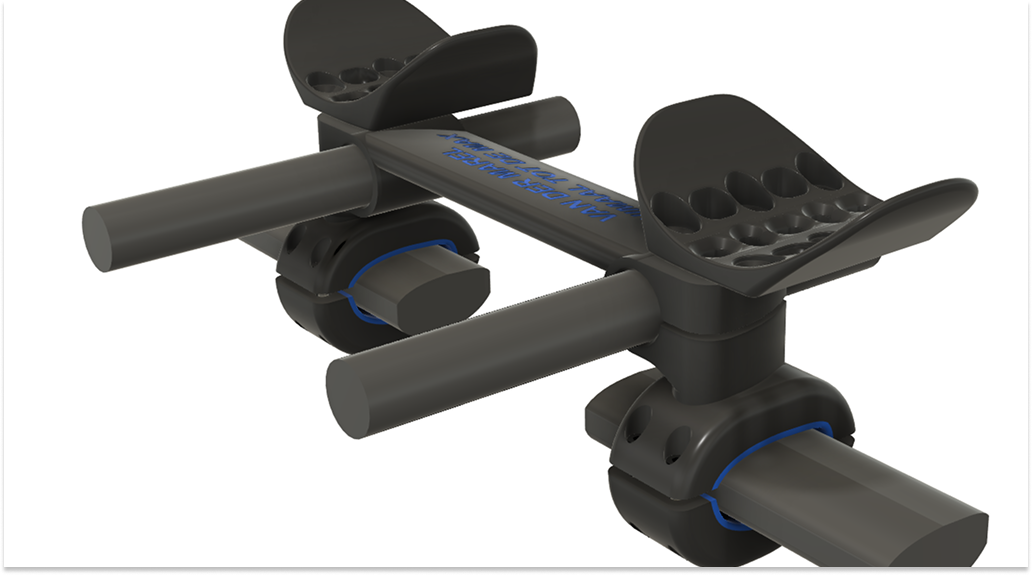

Traditionally, this would be a dead end. But with the help of additive manufacturing, Pim created a completely customized aerobar mount and bridge that fit the bike perfectly - offering a stable, durable solution with low cost and high functionality.
“This problem couldn’t be fixed before,” Pim says. “There was no existing solution that fit.” So instead of compromising the bike setup or ditching the aerobars altogether, he turned to 3D printing - a smart choice for one-off parts that demand precise dimensions and strength.

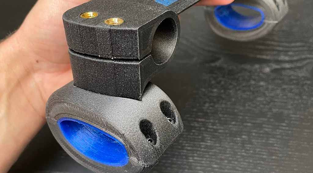

Printed on UltiMaker S8, Pim could leverage the open material system and dual extrusion capabilities. Using TPU and Nylon CF Slide, the custom part was both strong and lightweight - ideal for cycling applications. PLA was used to quickly prototype and test the shape before moving to the final print.

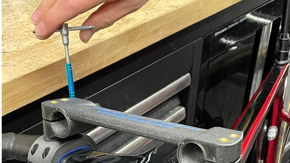

After a few adjustments, the mount proved strong, stable, and effective, offering the cyclist the aerodynamic setup they were after.
The ability to tailor the part to the bike’s exact geometry eliminated the need for any compromise - or expensive manufacturing alternatives.
To ensure the carbon handlebar remained undamaged, a TPU 95A layer was added. It required only minimal sanding for a smooth fit and provided extra protection during use.

Durable & lightweight: Nylon CF Slide delivers strength and performance at a low weight.
Affordable innovation: Prototyping and final part production were cost-effective, even for a one-off solution.
Protection built in: The dual material combination of TPU and Nylon CF Slide adds a barrier between the mount and bike – no damage, no worries.
