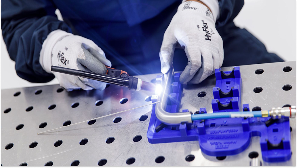

This week, we’re turning up the heat with a behind-the-scenes look at a 3D printed welding fixture used by our customer ERIKS. While welding and 3D printing might seem like unlikely partners, ERIKS is proving that with the right tools and materials, they’re a perfect match.
Jigs and fixtures are essential for holding components in place while maintaining alignment throughout the welding process. But when parts vary in shape, size, or volume, traditional fixtures can be expensive and time-consuming to make. That’s where 3D printing steps in.
Using the UltiMaker S5 and "ERIKS Blue" PETG, ERIKS is creating fully customized welding jigs - tailored to each job.
ERIKS is also exploring modular fixture systems: interchangeable straight sections, T-sections, corners, and custom shapes that fit together like a puzzle. Need to adapt your setup? Just swap out the parts - no waiting, no delays.
Worried about high welding temperatures? For heat-sensitive environments, switching to a high-temperature material like UltiMaker PET CF ensures fixtures can handle the stress while delivering long-lasting durability.

Thanks to in-house 3D printing, custom jigs can be designed and produced within hours, not days or weeks. When every hour counts, that’s a game changer.
Operators can assemble fixtures from modular sections, adapting to different weld jobs with ease. It’s like building a custom toolset - piece by piece.
Thanks to 3D printing, custom labels were made possible. Clear, embedded labels or instructions help ensure proper setup and minimize errors.
From tough PETG to high-performance PET CF, selecting the right material for the job is made possible with versitle options of filaments.
