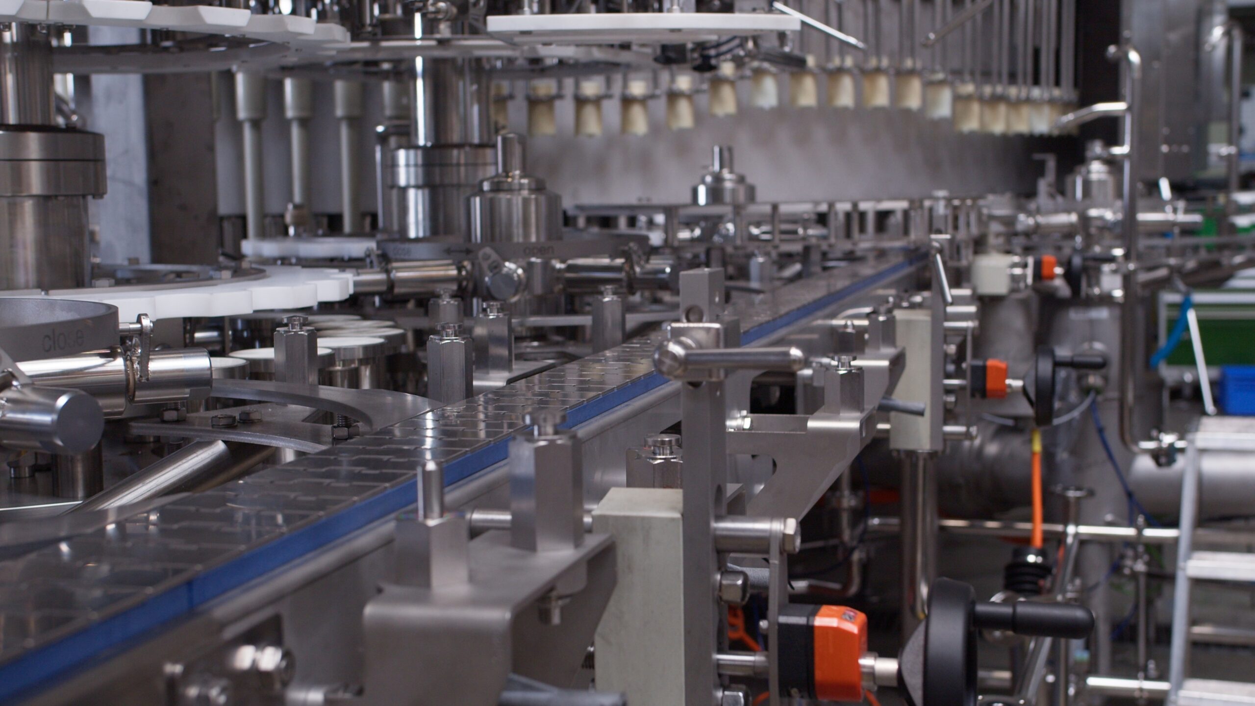

This week, we’re keeping production lines running smoothly with a closer look at a 3D printed guide rail system designed for a high-speed bottle packaging line. While conveyor systems and 3D printing might seem like an unusual pair, this application proves just how powerful the combination can be.
Read on to learn more.
Guide rail systems are an important feature of conveyor lines, especially in food and beverage production. They ensure bottles, cans, and other containers stay perfectly aligned as they speed through straight sections, curves, and corners. But when products vary in size or shape, traditional guide rails can be costly and slow to adapt. That’s where 3D printing steps up.

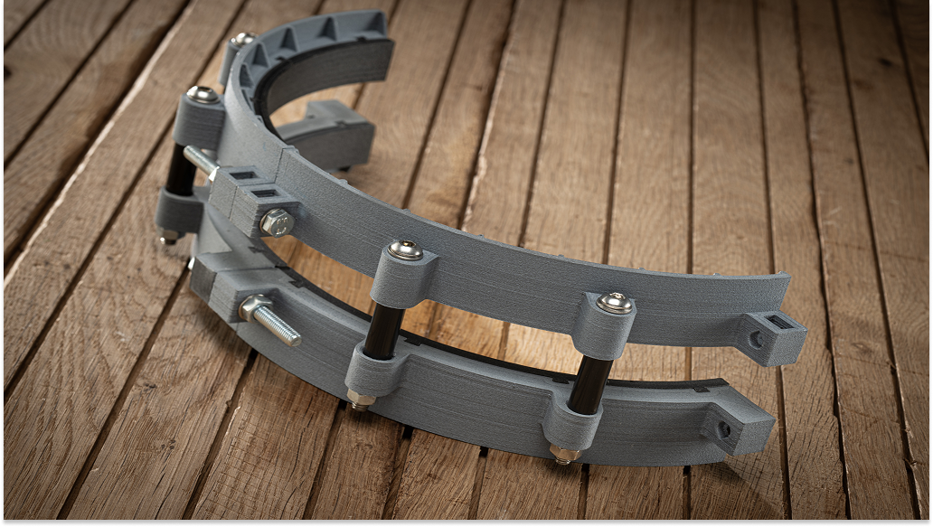

The team produced a fully customized guide rail system tailored to their specific packaging line needs. Two materials were used: tough, rigid PET CF Gray for the structural parts, and a low-friction, wear-resistant material for the contact surfaces that guide the bottles safely through the line.
Worried about wear and tear? No problem. With this clever design, the low-friction wear strips are printed separately and simply slide into the main structure. When the strips show signs of wear, you don’t need to replace the entire rail – just swap in a new strip. It’s fast, cost-effective, and minimizes downtime.
Here’s why this 3D printed guide rail system is a game changer for packaging lines:
Wear strips alone cost around €7–8 to print, while the full part is about €25. When replacements are this easy and affordable, maintenance becomes a breeze.
By using high-performance PET CF for the structure and a low-friction material for bottle contact, the system delivers both strength and smooth operation.
Instead of replacing entire rail sections, operators can quickly slide in new wear strips – no tools, no hassle, and no extended production stops.
