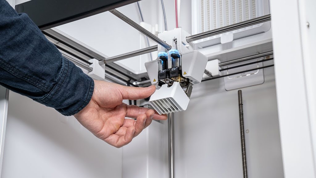

Types of multiple filament 3D printer systems
Several types of multiple filament 3D printer systems exist, each offering its own advantages and considerations. A clear understanding of these different approaches helps users select the solution that best fits their needs.
Dual extruder systems are a common and reliable option for multi-material printing. UltiMaker's S-series printers, including the UltiMaker S7, S5, and the newest S6, feature dual extrusion with two independent nozzles.
This design allows for quick print times by eliminating the need for filament switching during the printing process. These systems excel at combining different materials or colors and are particularly suited for printing support structures with dissolvable materials like PVA. The ability to use two materials with vastly different properties makes UltiMaker dual extruder systems efficient for a wide range of applications.

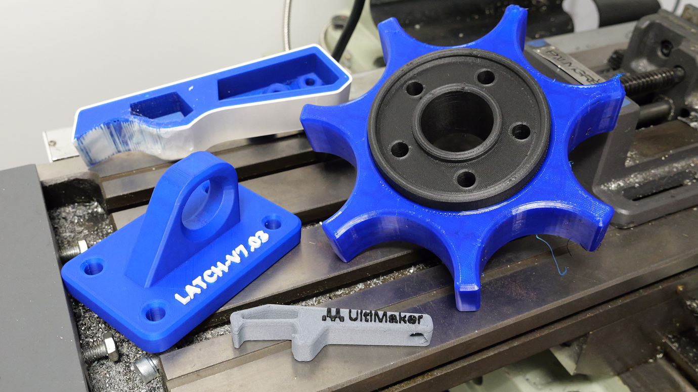

Applications of multi-material printing
Multi-material printing with UltiMaker systems has created a range of applications across industries, changing product design and manufacturing. One key application is the creation of complex functional parts. The University of Central Lancashire utilized UltiMaker technology to develop a prototype exoskeleton combining PLA for the internal core with Nylon and TPU for the external shell, demonstrating how UltiMaker's dual extrusion capabilities can create advanced medical devices.
Support material for complex geometries is another important application of multi-material printing. UltiMaker's PVA support material enables the printing of intricate designs with internal cavities that would otherwise be impossible to produce. This water-soluble support dissolves completely, leaving no trace on the finished part and eliminating the need for manual support removal that could damage delicate features.
In the automotive industry, Volkswagen Autoeuropa developed innovative liftgate badge jigs using TPU for the surface in contact with the car to prevent paint scratches, while using a rigid structural filament for the frame. This application of dual extrusion showcases how multi-material printing can solve specific manufacturing challenges by combining materials with complementary properties.
Visual prototypes benefit from UltiMaker's dual extrusion capabilities through color effects. Prototypes with multiple colors, architectural models with color-coded sections, and educational models highlighting different components can all be produced quickly, enhancing communication and understanding of design concepts across fields.
For end-use parts, UltiMaker's multi-material printing allows for the production of functional components with integrated features. A compelling example comes from a packaging company that redesigned a part that pushes 8-packs of cans. Using material interlocking in Cura, they printed the inside with red PLA for structure and the outer layer with wear-resistant Nylon. This not only improved functionality but also created a wear indicator as the red inner material became visible when the outer layer wore down.
Medical applications of multi-material printing are impactful. Patient-specific anatomical models with color-coded regions aid in surgical planning and education. Prosthetics combining rigid and flexible components can be customized for individual patients, improving comfort and functionality. Dental models with soft tissue analogs provide more realistic training and fitting experiences.
In tooling and manufacturing, multi-material printing enables the creation of injection mold inserts with conformal cooling channels and custom jigs and fixtures with integrated soft-touch areas. These applications can reduce lead times and costs in industrial settings while improving tool performance and ergonomics. However, these advanced techniques can present unique challenges, addressed in the following section on troubleshooting.

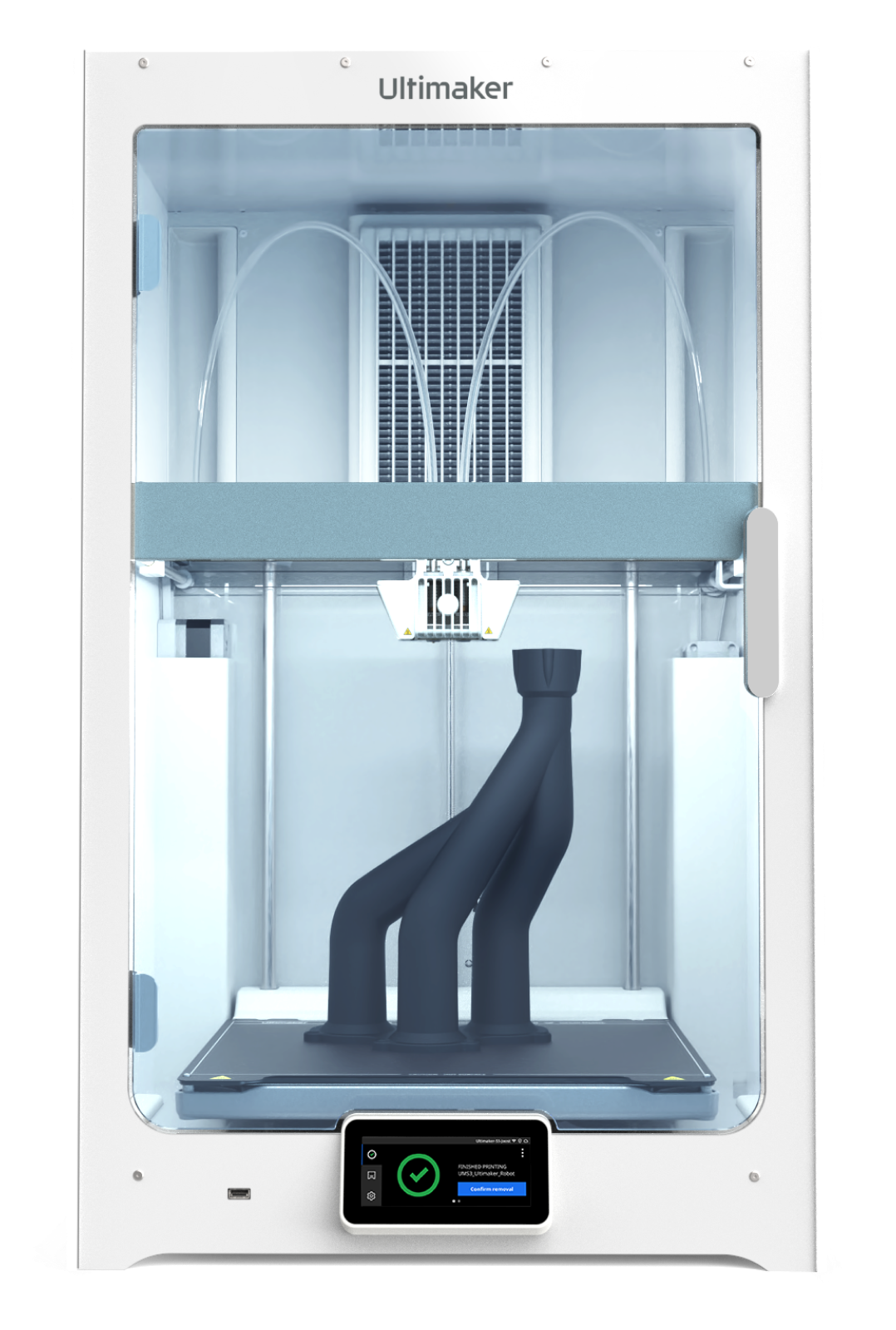

UltiMaker S6: Faster, smarter, more accessible multi-material printing
