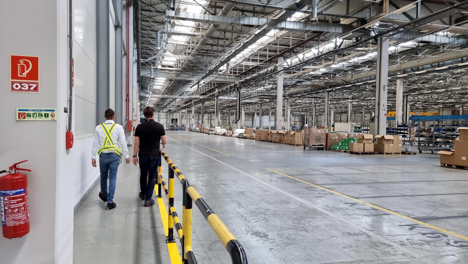

A tour of the plant under construction

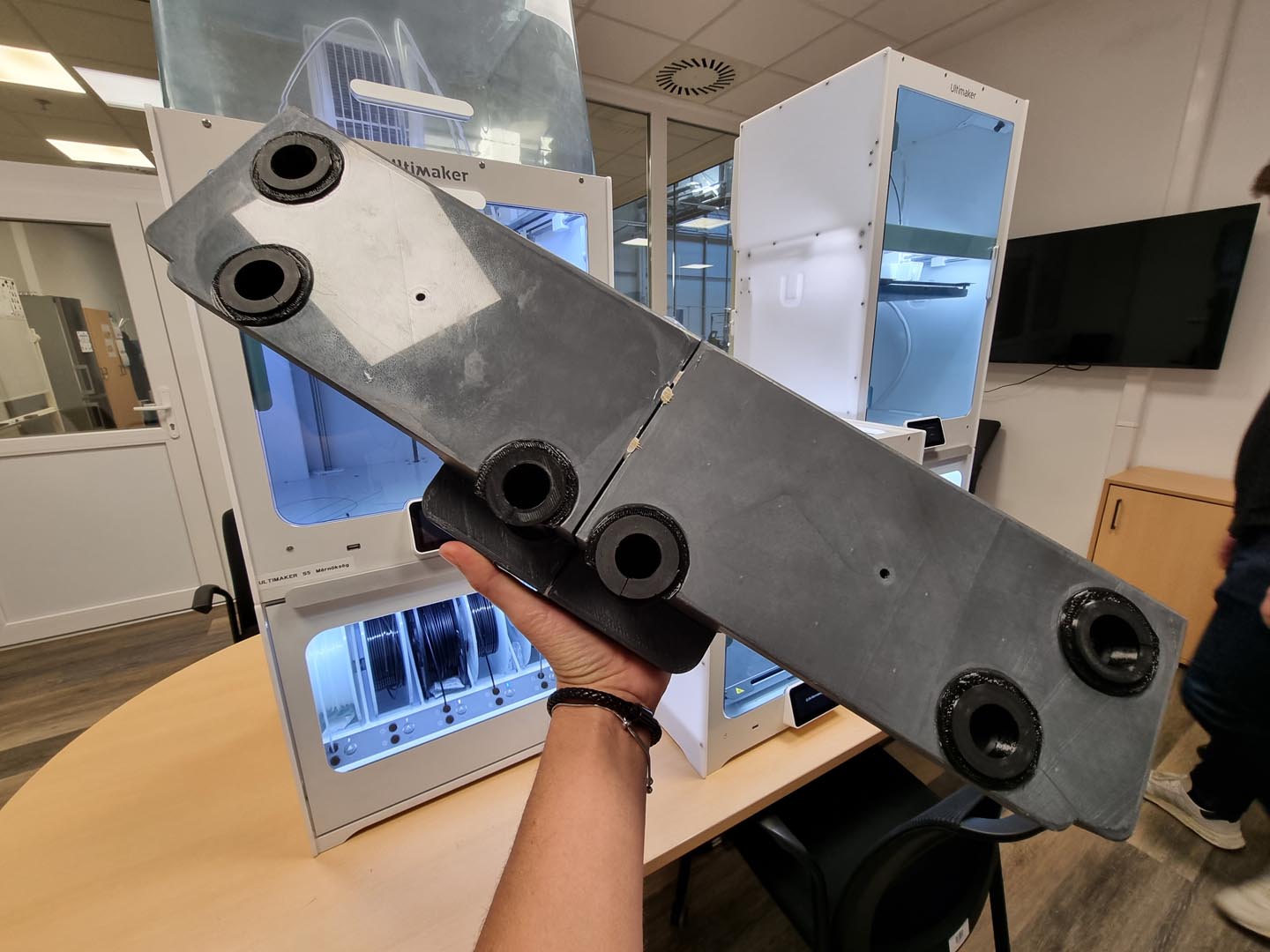

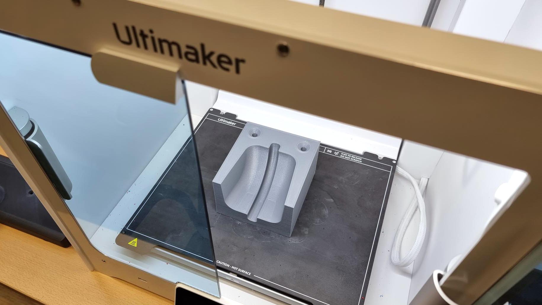

Printed seat on the UltiMaker S6 tray

The economic benefits of in-house 3D printing capacity are by no means negligible. From this perspective, one of the team's most successful projects was a technological positioning jig that can withstand loads of up to 2.5 tons. They received a very high quote from an external supplier for aluminum, while 3D printing on existing UltiMakers cost no more than a tenth of that.
"The investment in the UltiMaker S7 Pro Bundle paid off immediately with just these ten positioning jigs," says Péter.

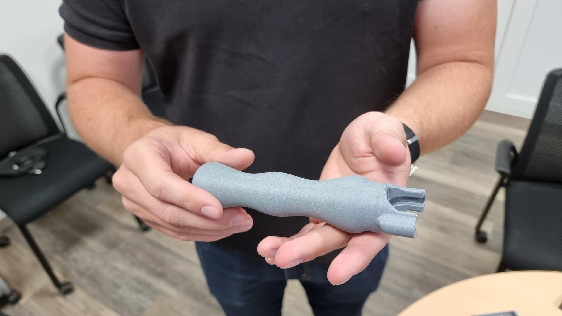

Handle printed from UltiMaker PET CF

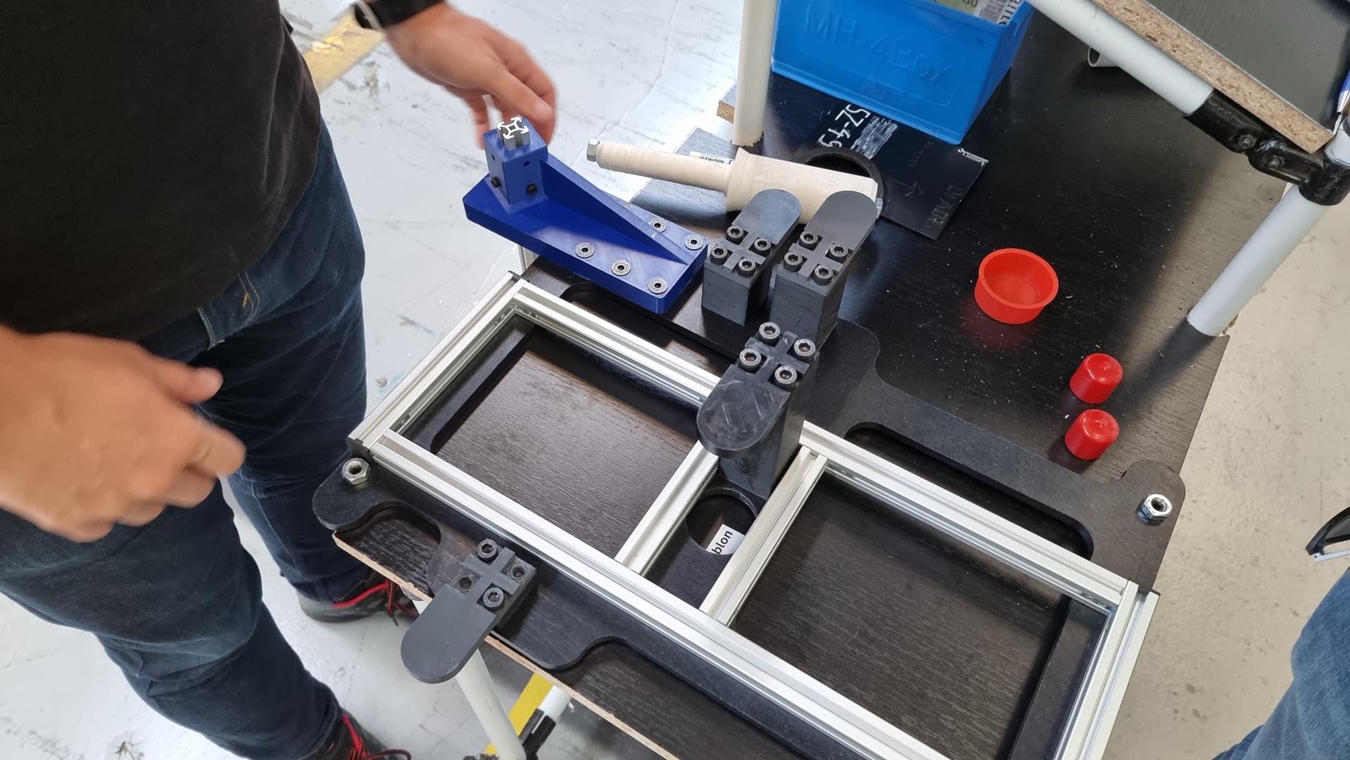

Printed jigs on the first production line

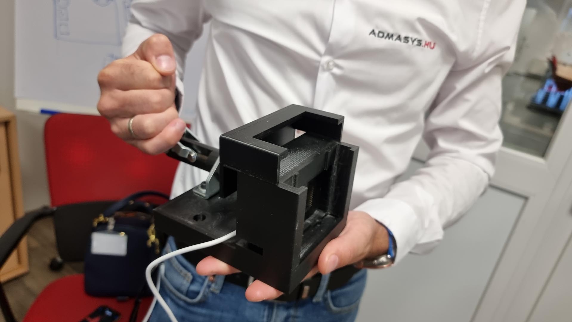

Printed device for testing electronics
