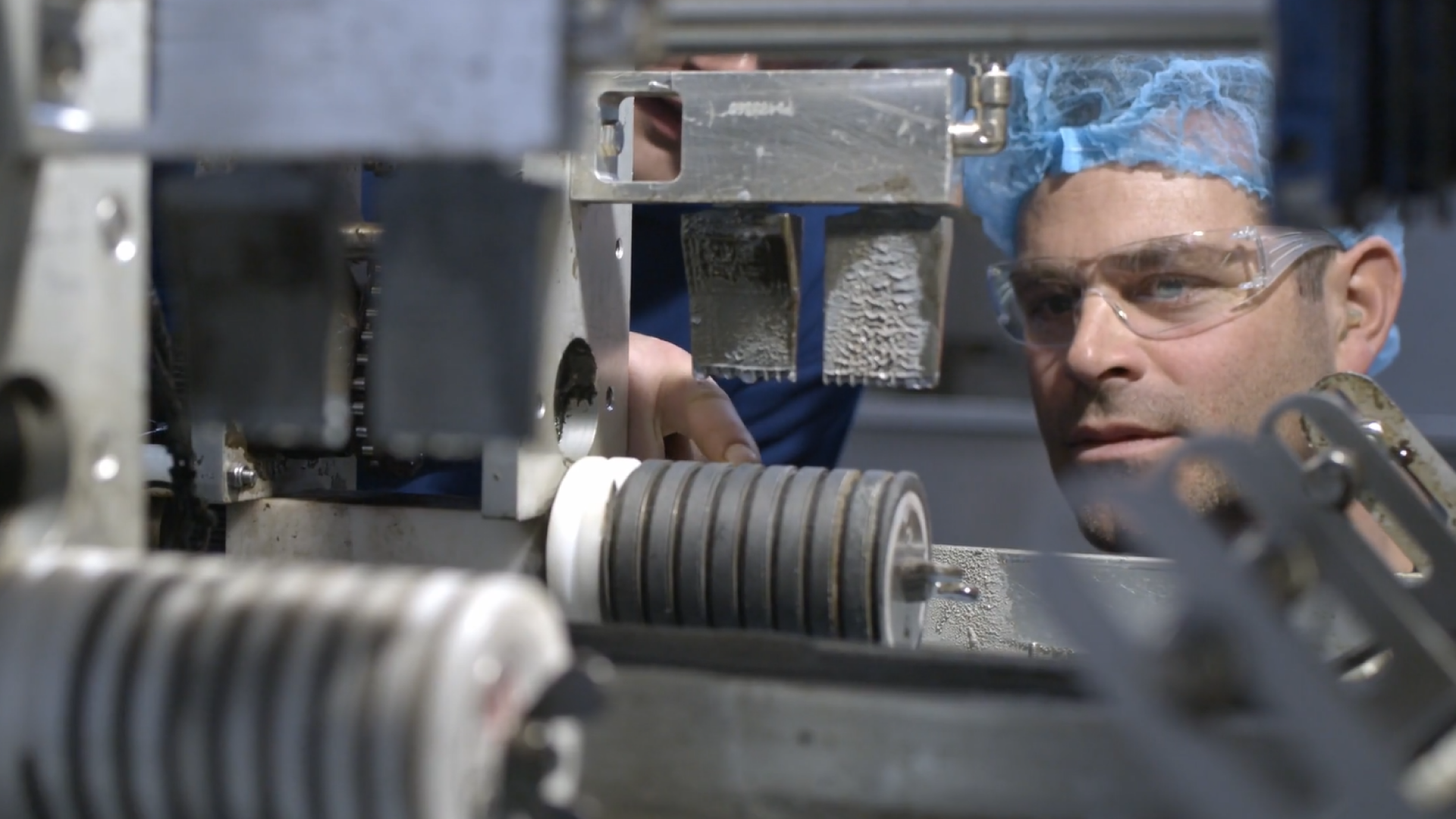

The focus of Trivium’s recent innovation was the Anode Worm, a critical component that transfers can lids through a coating bath. This part must perform a complex balancing act: it conducts electricity to the lids for the coating process, yet it must remain wear-resistant, chemical-resistant, and moisture-resistant to survive the bath itself. Traditionally made from foam, these parts were prone to wear and required frequent replacement. Trivium needed a material that was:
Using an UltiMaker S5 equipped with a CC 0.4 print core, the engineering team printed the Anode Worm using Nylon CF Slide. This carbon-fiber-reinforced material provided the structural rigidity and low-friction "slide" properties required for the coating line.

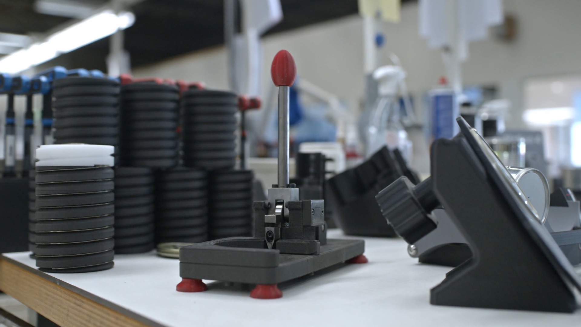

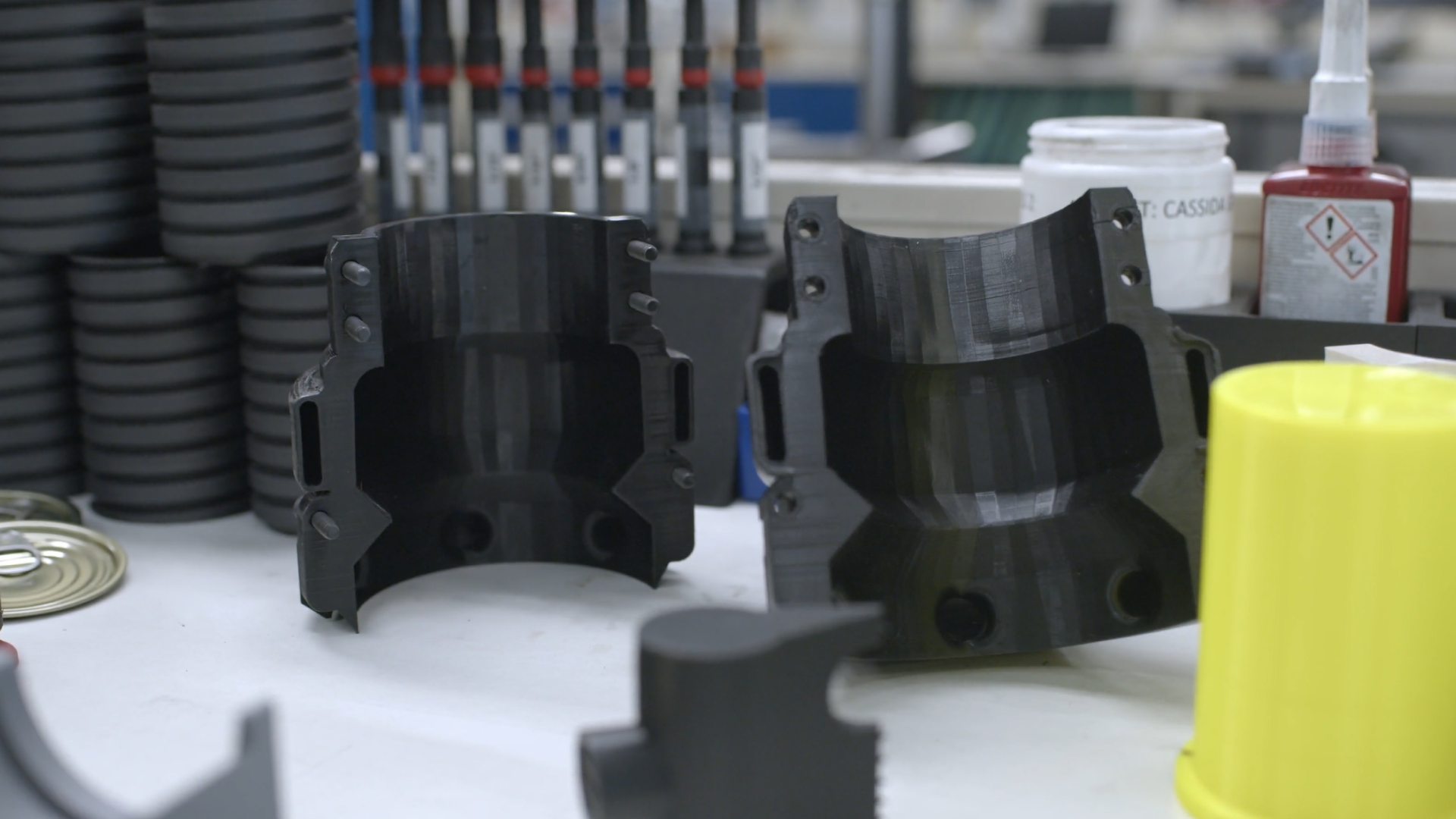

Precision Industrial Parts: Specialized housing and production-ready components 3D printed with Nylon CF Slide.
Composite Manufacturing Aids: Durable screw mounts and custom fixtures engineered for continuous factory floor use.

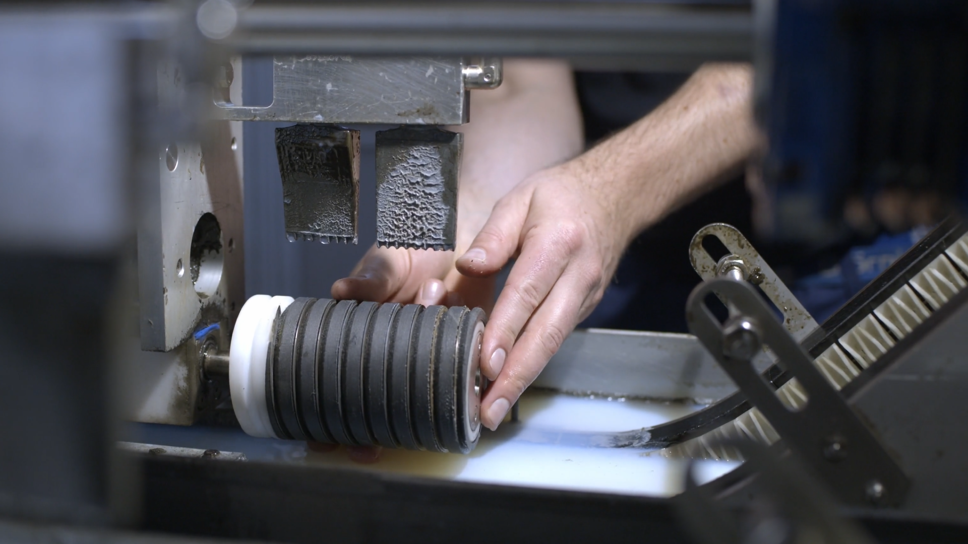

Because the part was designed in-house, the team was able to optimize the grooves of the worm to fit the can lids more accurately than the legacy foam parts. This customization ensured a smoother transfer and fewer jams on the line.
During production tests, the team discovered a unique advantage: the coating material did not adhere to the Nylon CF Expansion. This "self-cleaning" property allowed Trivium to skip an entire cleaning cycle, maintaining consistent performance over longer periods. Furthermore, the low-friction nature of the material reduced wear on the surrounding metal machine parts."The material met all the requirements and even performed better than expected. During real production tests, we noticed the coating did not attract to the Nylon CF Slide material, so we could skip a cleaning cycle and performance stayed consistent."
The shift from outsourced foam parts to in-house 3D printing resulted in a 95% reduction in costs. Beyond the financial savings, the lead time was slashed from weeks to hours, allowing the team to iterate on designs and implement improvements instantly.
