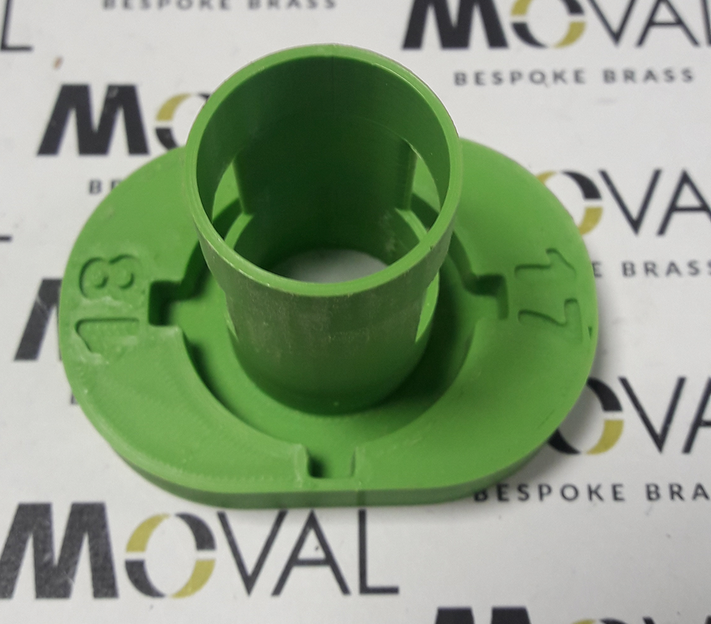

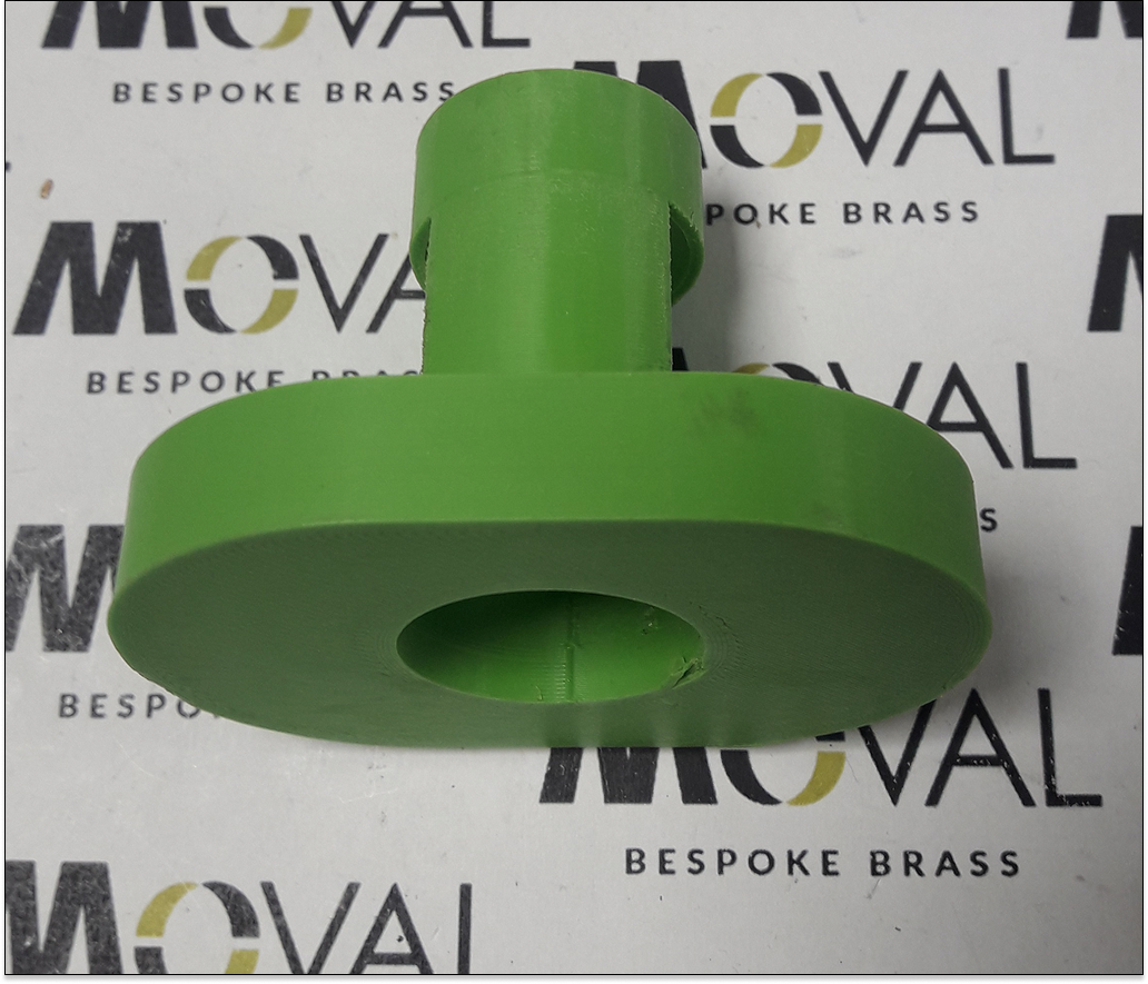

This gauge is designed to verify the dimensional accuracy of a part by inserting it into the 3D printed fixture. Printed in green PLA, Emanuele was able to customize it by designing size indicators directly on the gauge.
With the new S8 printer, the print resulted in an improved surface finish with no post-print processing needed. Thanks to the UltiMaker Cheetah motion planner, the gauge took 1h 49 minutes to produce, compared to the previous print time of 6 hours and 34 minutes.

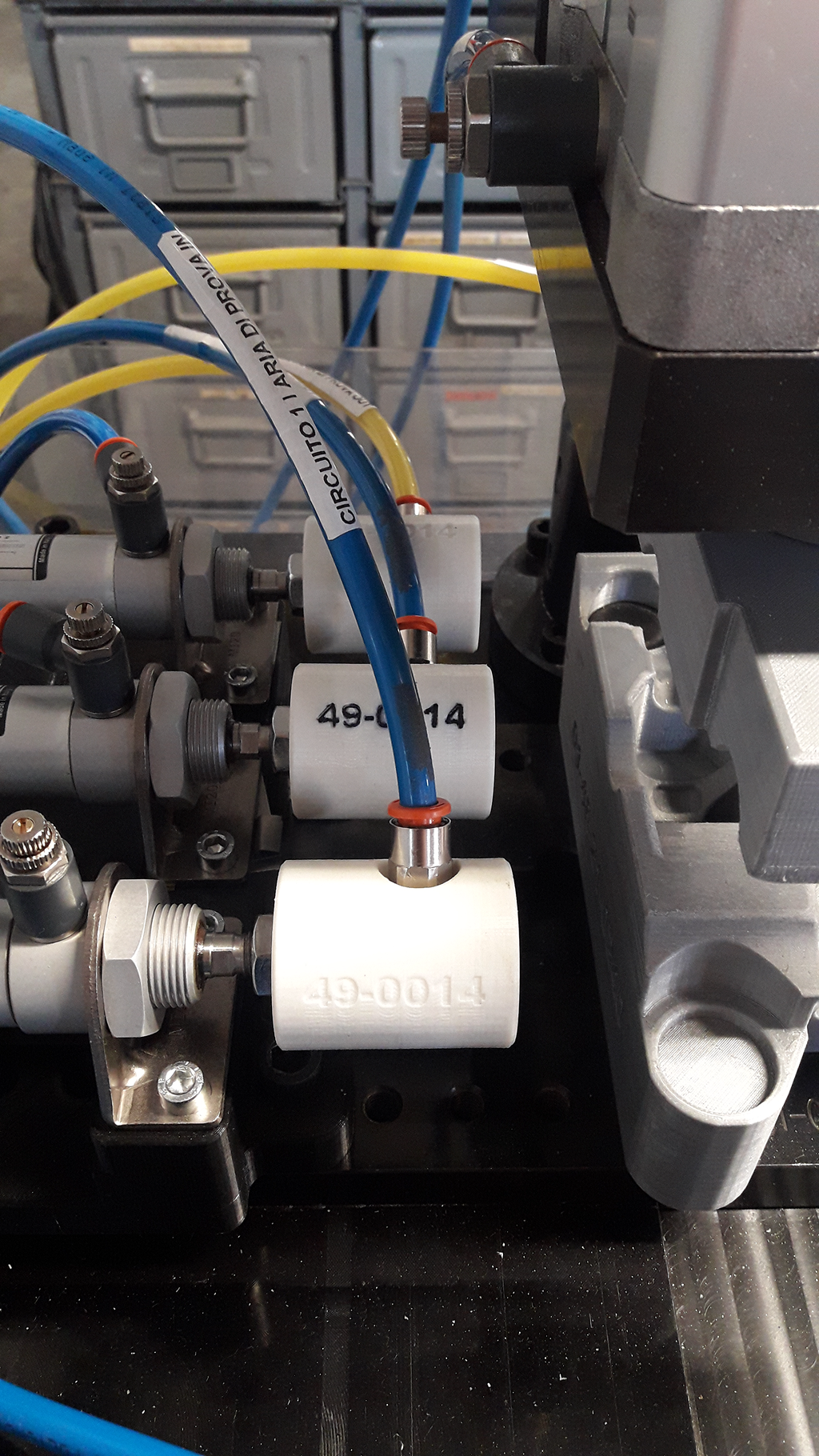

Another small yet impactful application of additive manufacturing has been the production of gasket covers for air pistons. By using UltiMaker S8 and TPU 95A he was able to create a precise fit that offers improved sealing and protection.

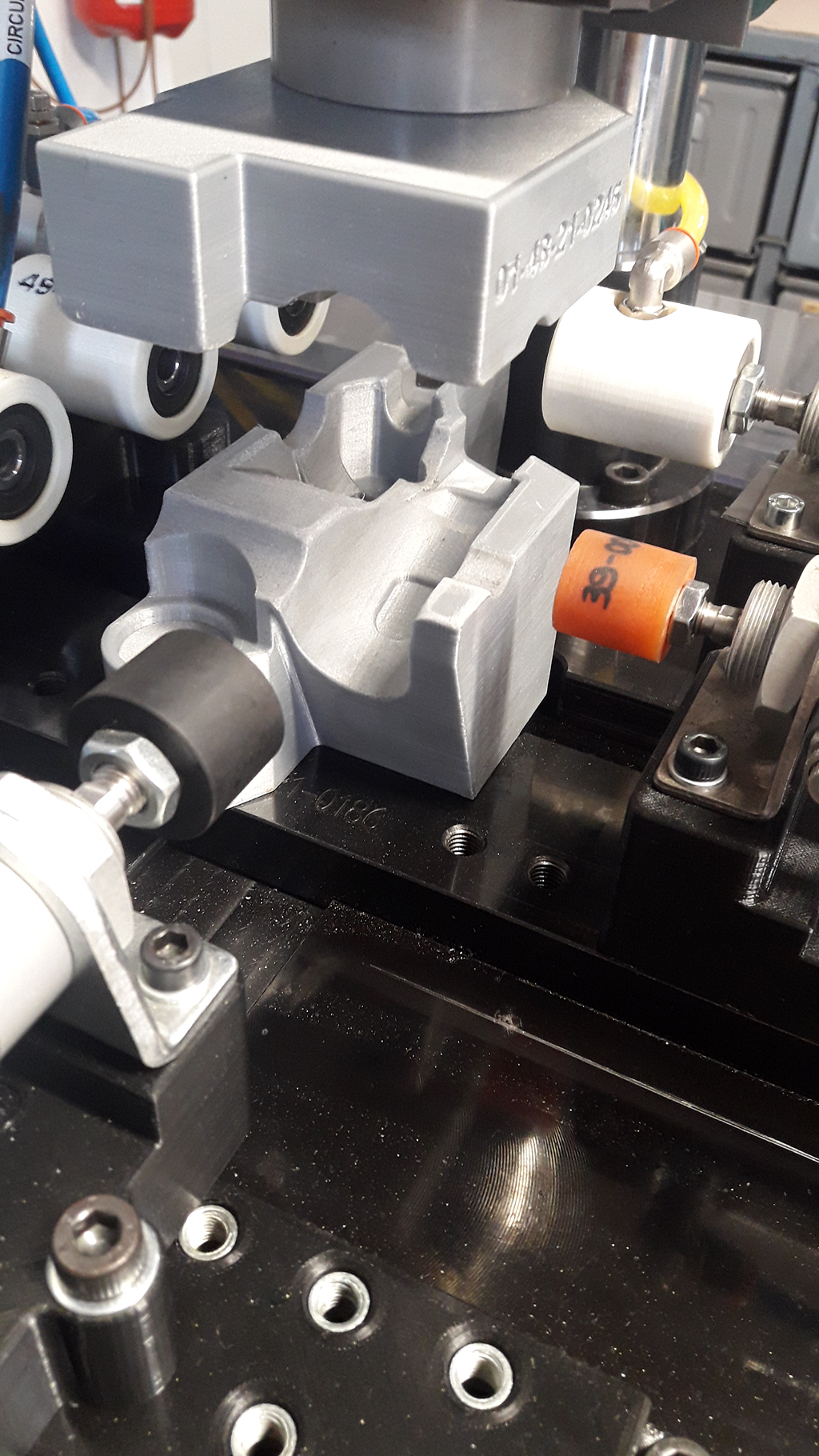

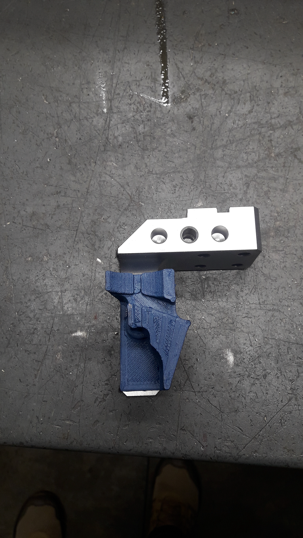

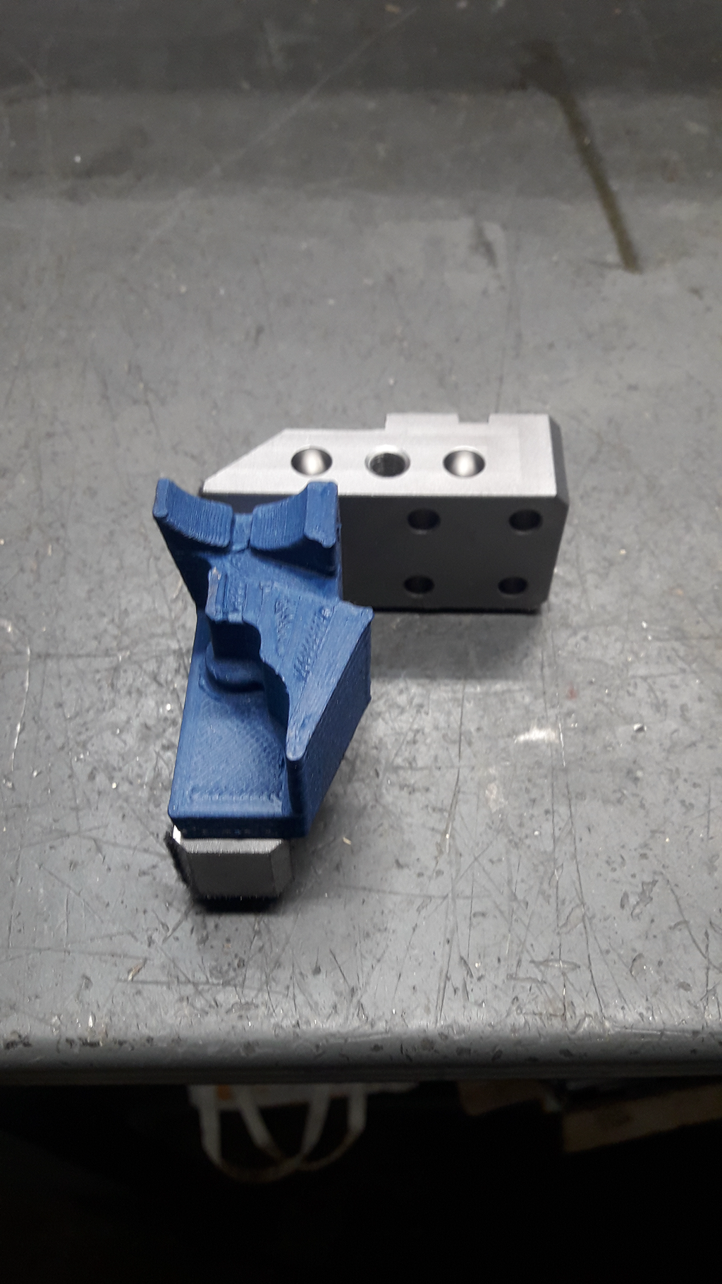

Printed with the S8 on blue PET CF, this jig is in constant contact with machinery, so choosing a wear-resistant material was crucial.
