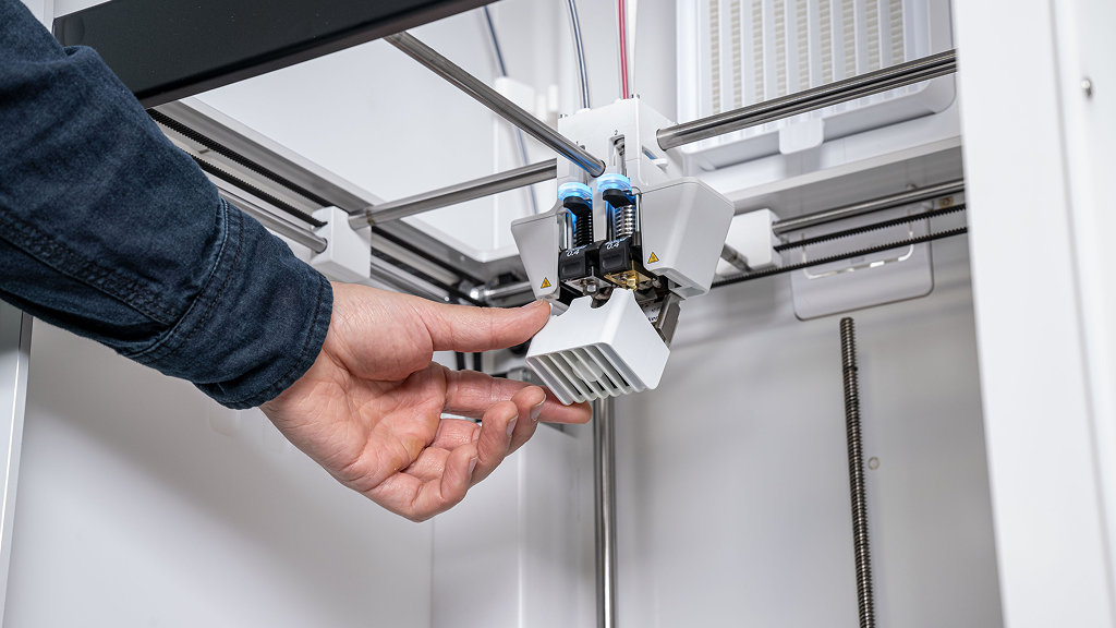

Dual-extruder systems
The most reliable professional solution that features two independent print cores.
Pros: Proven, easy to use, fast print times with minimal complexity, and in the case of UltiMaker 3D printers, fully supported by preset slicing profiles optimized for printing.
Cons: Limited to two materials per print.

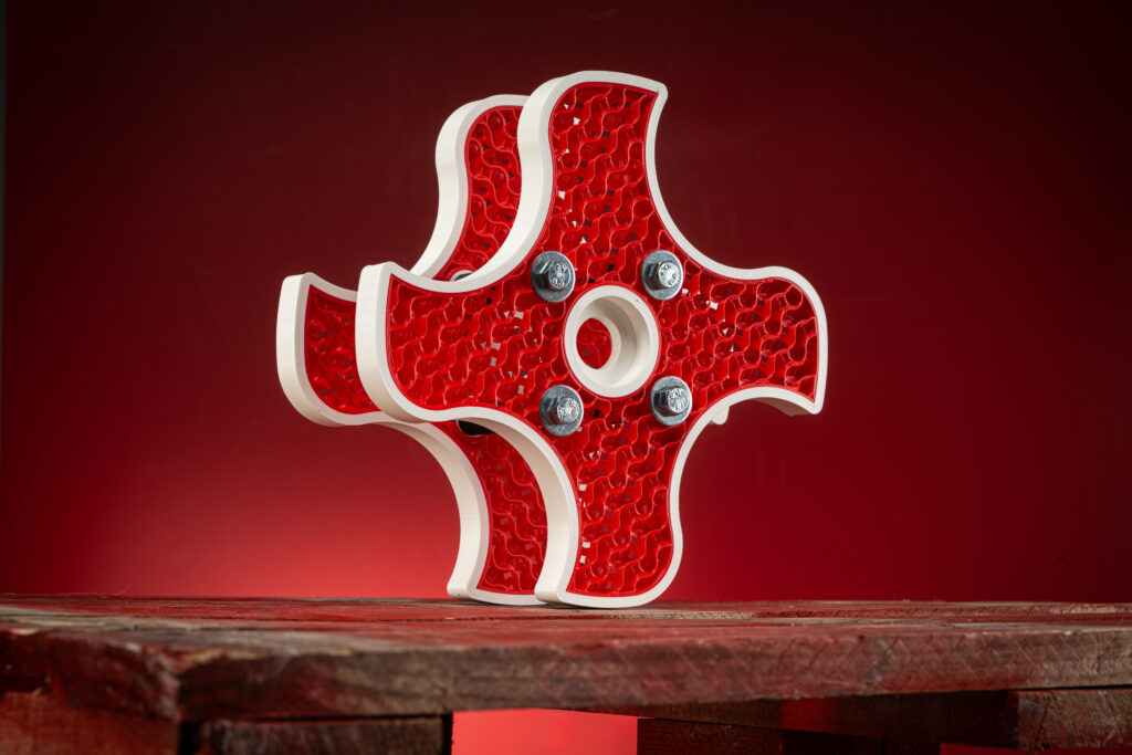

Another example of an application, used by Heineken Sevilla, is this can pusher part which combines PLA (used for the inside of the part) with Nylon (used as a wear-resistant material for the outer layer).
Aside from the mechanical benefits of combining the two different materials, the use of different colors means that the internal red PLA acts as a wear indicator becoming more visible as the outer Nylo layer wears down.
Design and product optimization
From rapid prototyping to on-demand production, 3D printing allows manufacturers to save costs, decrease lead times, maintain production uptimes and minimize waste. Each of these advantages are further compounded by multi-material printing capabilities as printed parts can be optimized further in a myriad of ways:
Components like infeed wheels can have the bulk of their structure printed from a stiff high resistant material and have their outer wall printed with a low friction material to increase the component’s longevity in a production line.

Speed, reliability, and consistency with the UltiMaker S8
The UltiMaker S8 is engineered to deliver fast, consistent, and reliable dual-material 3D printing for professional environments. With a focus on high productivity and accuracy, it enables engineers to produce complex, multi-material parts with confidence.
Key features supporting multi-material performance:
  • Dual extrusion with interchangeable high flow print cores (AA, BB, CC) makes switching between different build and support materials seamless and efficient.
  • The new UltiMaker Cheetah motion planner enables movement speeds of up to 500 mm/s and acceleration up to 50,000 mm/s², maintaining print quality while significantly reducing build times.
  • A re-engineered material feeder with hardened steel gears ensures reliable filament handling, reducing slip and maintaining consistent extrusion, even with flexible and abrasive materials.
  • Active build plate leveling and dual filament run-out sensors safeguard long, complex builds, ensuring consistency and reducing the risk of failed prints.
  • NFC material recognition automatically detects and applies the correct material profiles, streamlining setup and reducing operator error.
  • Full integration with UltiMaker Digital Factory provides cloud-based management for print job preparation, slicing, queuing, monitoring, and collaboration, ideal for multi-user, multi-printer environments.
