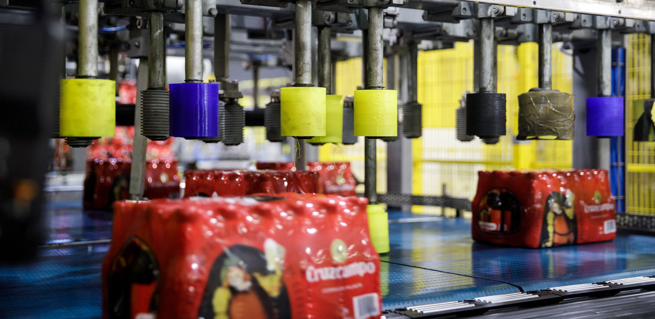

Thanks to its ability to bend, stretch, and recover shape, TPU is used in a wide range of functional applications. These include shock-absorbing components, seals, protective covers, orthotics, and parts for consumer electronics and wearables. It’s also valued in automotive and industrial settings for its resistance to abrasion, oil, and chemicals.
