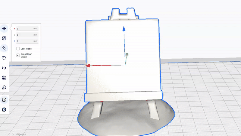

New painting tools for precision control
Cura 5.11 introduces a set of paint-on features designed to give you more flexibility and control when preparing your prints:
  • Paint seams directly on your model to define where Cura places the z-seam, or block areas where seams should not appear.
  • Paint extruder assignments for multi-material printing. Easily designate different regions of your model to different extruders with a simple brush workflow.
  • Save painted preferences in project files, ensuring consistency across print jobs.
These new painting tools make it easier than ever to fine-tune the look, feel, and performance of your parts.
