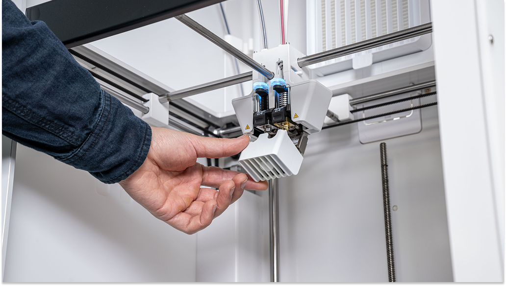

UltiMaker S series 3D printers
To push 3D printing technology further, we developed a new motion planner - the UltiMaker Cheetah motion planner. Not only does it reduce the effects of high force peaks on the print head but it eliminates the speed jumps that cause them entirely. This ensures that every movement of our printer is smoother, more controlled, and highly accurate.
Our motion planner applies input shaping to motion profiles to further reduce any remaining vibration artifacts. With these optimized motion profiles, the input shaper becomes even more effective in delivering superior print results. Additionally, pressure advance ensures that material flow accurately follows the motion profiles of the print head, preventing inconsistencies in extrusion.
